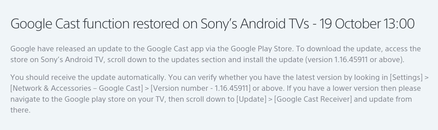

[RESOLVED] Casting Not Working
Problem:
Unable to cast from various devices to the tv. See main discussion thread: HERE
Reported by:
Various people
Updates:
16-10-2015:
Sony has confirmed this issue and is in contact with Google to resolve this, as it appears its a global issue and not just EU. This is being addressed with urgency.
17-10-2015:
Google has issued an update to its GoogleCast software which has resolved this issue. Please ensure that you have this version: 1.16.45911
19-10-2015:
Sony has issued the following statement - however if anyone is still having issues even after updating, please factory reset the tv
http://www.sony.co.uk/support/en/content/cnt-hn/prd-tvhc/GoogleCast-temporarily-unavailable
