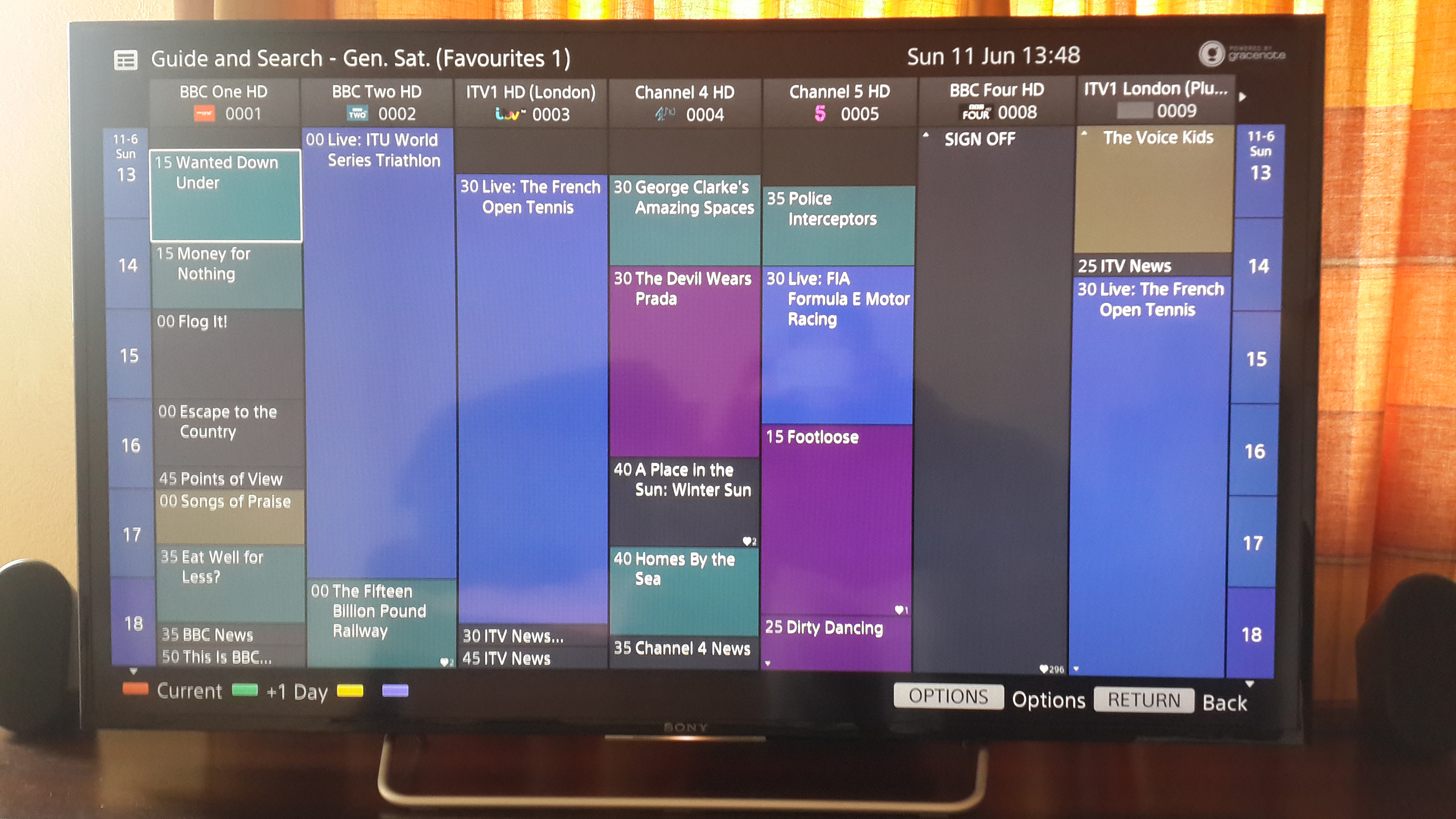

Anyway i have managed to sort it with a hard reset, unplug TV from mains for a minute or two, turn on, wait a minute then hold up on TV remote and turn TV off and back on via TV standby button.
Set TV up now all my Satellite EPG is completely populated, some channels you have to assign the correct name but once done everything is completely sorted now.
Btw it does say "Powered by Gracenote" in top right corner.
I have disabled auto updates for software as im pretty sure it all started with the v3.004 software for me as it was working ok before. (KDL-48W705C connected to router via LAN)
