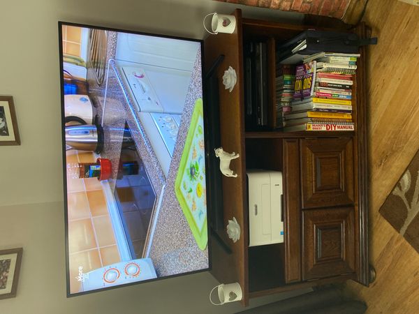

picture of my tv
That really is very strange and something that only Sony could give an answer to.
The TV is clearly the KD-55XF7003 as the label on the back confirms and the position of the legs/ stand.

picture of my tv
Hi @Claire75 It is difficult to scale a photograph, so could you measure the diagonal. It looks like 43” to me and not 55”. I would tend to believe what is displayed on the screen and not what’s on the label.
Just in case you are not familiar with the Sony model numbering, the 43/55 is the diagonal distance in inches.
