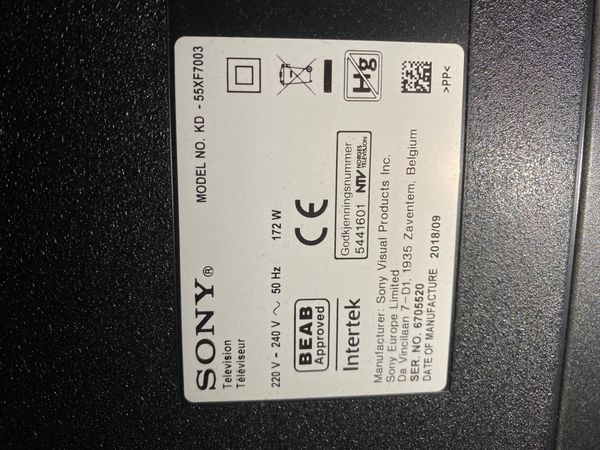

So I have a Sony KD-55XF7003 I got a message about an update yesterday but as I’ve gone into customer support the model number is in correct it’s stating KD-43X7000E what do I do

Are you able to share a picture of the TV and then perhaps a picture of the Customer Support screen
with the model number.
Have you checked the label on the back of the television.

The top is what it’s saying the bottom is what is on the back of my tv, I don’t know if a factory reset will sort it I can’t understand how this has happend I have opened a case with Sony and will be ringing them on Monday

picture of my tv

That really is very strange and something that only Sony could give an answer to.
The TV is clearly the KD-55XF7003 as the label on the back confirms and the position of the legs/ stand.
You could try a factory reset and see if that clears the issue, or go ahead with the update and see if that
resolves the issue.
Did you buy this TV new and has it ever been repaired. I had a smaller version of your TV the KD43XF7073 and it had to have its mainboard replaced (apparently a common fault in these models) and I was wondering if your TV had a similar repair they may have input the wrong ID when putting the TV back together.

Yes I bought the tv from new and has never been repaired and because it’s comming up as an older model it won’t let me update I’m a apprehensive of doing factory reset as I don’t really understand it all

@Claire75 wrote:
picture of my tv
Hi @Claire75 It is difficult to scale a photograph, so could you measure the diagonal. It looks like 43” to me and not 55”. I would tend to believe what is displayed on the screen and not what’s on the label.
Just in case you are not familiar with the Sony model numbering, the 43/55 is the diagonal distance in inches.
Where did you buy it from new?

@Claire75 wrote:Yes I bought the tv from new and has never been repaired and because it’s coming up as an older model it won’t let me update I’m a apprehensive of doing factory reset as I don’t really understand it all
Hi @Claire75
There should be no need to perform a factory reset. However, it is a good idea to measure the TV diagonally in inches.
If it is 55 inches, then the model number is KD-55XF7003.
KD-55XF7003 Specifications | Sony UK
If it is 43 inches, then the model number is KD-43X7000E.
If it is KD-55XF7003 then there is a software update available.
Firmware update to v8.933 | Sony UK
If it is KD-43X7000E then nothing is available, but the UK model KD-43XE7000 has the same firmware update available.
The real question is for your Retailer (who sold you the TV), why the label does not match the device display.
