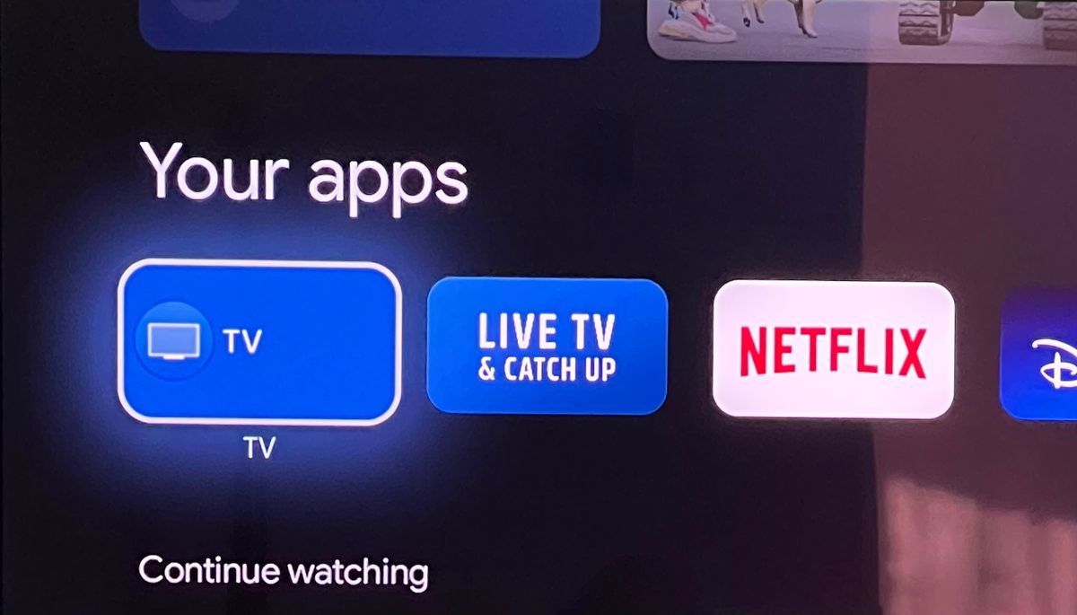

Hi @patansl
Here is a picture of the two Apps side by side. You can also set which one you want for watching live TV by default in the settings. Settings -> Channels &Inputs -> TV button shortcut-> Digital -> image below
Hi @patansl
It looks like you are using Live TV & Catch Up. Recording is not available in this mode because you can use Catch Up instead. To use the recording facility you need to use the native TV Guide so use the TV App instead, not the Live TV & Catch Up App.

Hi @patansl
@LightFoot - Wow! I never even knew there was another TV guide on the TV.
Recording does indeed work on that guide. Thank you for solving that mystery. Something that Sony support seem perplexed and unable to solve.
