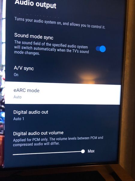

Don’t set the Sony remote to control the soundbar - have it set to control the TV alone, and eARC should take care of the rest. But do ensure eARC on the TV is enabled.
If this is not enough, look for Bravia Sync on the TV and Anynet+ on the Samsung (CEC in both cases), and make sure both are turned on.
If it still doesn’t work, go into Audio on the TV and look to see if the audio is set to output to the TV, or to an external device. Ensure it is set to external device, using eARC, and that the external device isn’t something other than the soundbar.

I've reset the soundbar so as to not use the Sony controls for the volume. No change as expected (i.e. it didn't work before and now, by design, doesn't work still!)
I've got eArc set to Auto on the TV:
and the soundbar is connected to HDMI3:
I've tried this as Standard Format as well, without success.
