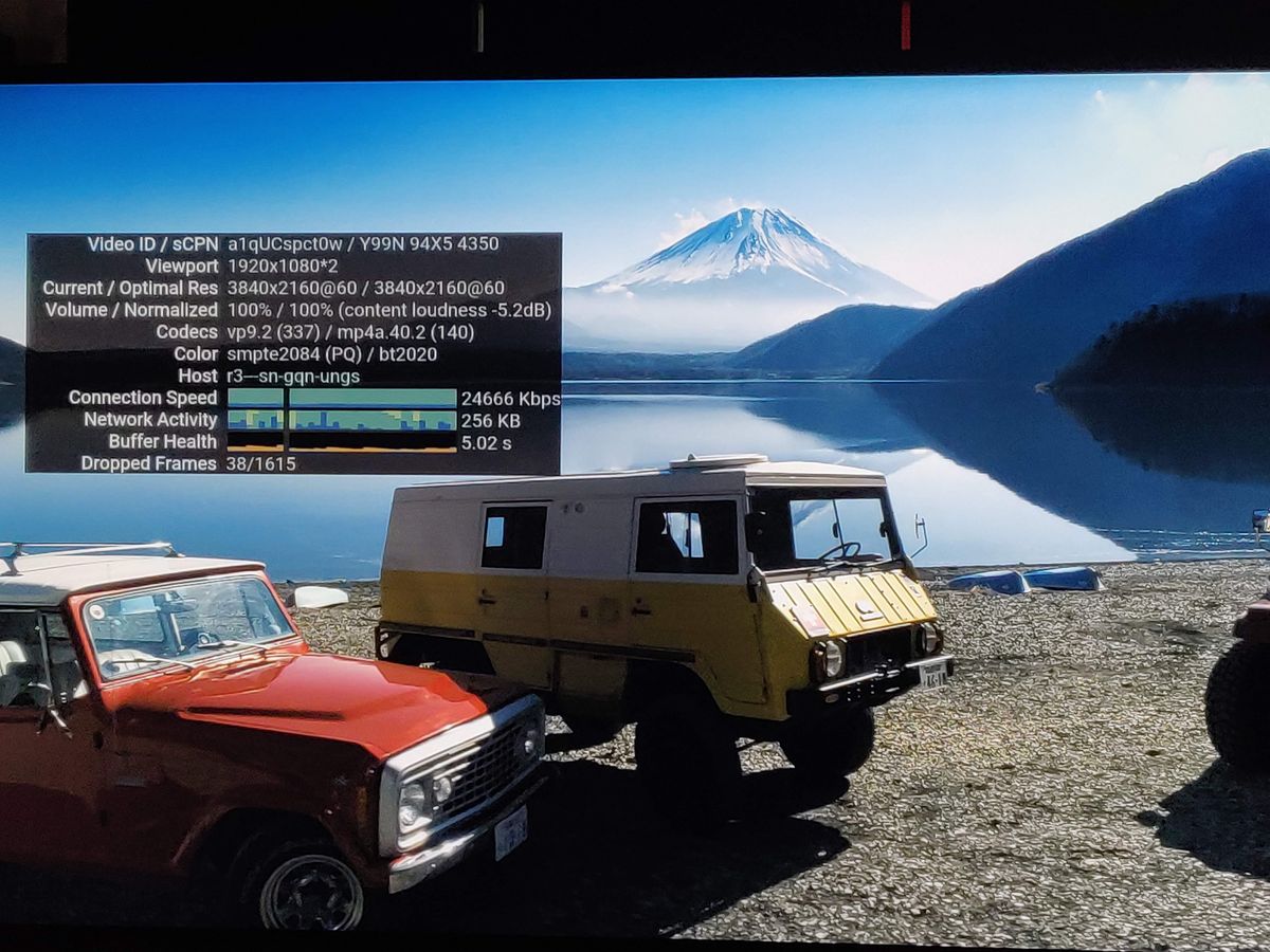

Looking at the "nerd info" on youtube, it seems as it lack some kind of metadata to help the tv identifying the right HDR involved (using AUTO)
I've seen that in one video in HLG and others in HDR10 that manually specifying the right HDR type it works as expected (max brightness, right color space) and the video quality is awesome
@rooobb wrote:Looking at the "nerd info" on youtube, it seems as it lack some kind of metadata to help the tv identifying the right HDR involved (using AUTO)
The metadata is there... This is the metadata info for The World in HDR, downloaded straight from YouTube with youtube-dl. Check at the end the lines in bold (PQ should mean it's in HDR. And BT.2020 is what we are discussing in here):
General Unique ID : 317899792610391996154637148508605156273 (0xEF2945E2B0F883183BC0E0CFEC3C8BB1) Complete name : /Volumes/NAS326/YouTube HDR/The World in HDR in 4K (ULTRA HD)-2160p 60fps.mkv Format : Matroska Format version : Version 4 / Version 2 File size : 341 MiB Duration : 2 min 34 s Overall bit rate : 18.5 Mb/s Writing application : Lavf57.71.100 Writing library : Lavf57.71.100 ErrorDetectionType : Per level 1 Video ID : 1 Format : VP9 Codec ID : V_VP9 Duration : 2 min 34 s Width : 3 840 pixels Height : 2 160 pixels Display aspect ratio : 16:9 Frame rate mode : Constant Frame rate : 59.940 FPS Color space : YUV Language : English Default : Yes Forced : No Color range : Limited Color primaries : BT.2020 Transfer characteristics : PQ Matrix coefficients : BT.2020 non-constant
Also I opened a ticket for the Smart YouTube app, asking if he could force the color space in the metadata. The answer has been negative because... Android doesn't allow to do so. At least that's what he said. So either the Codecs/APIs set the right color space, or we have to change it manually.
