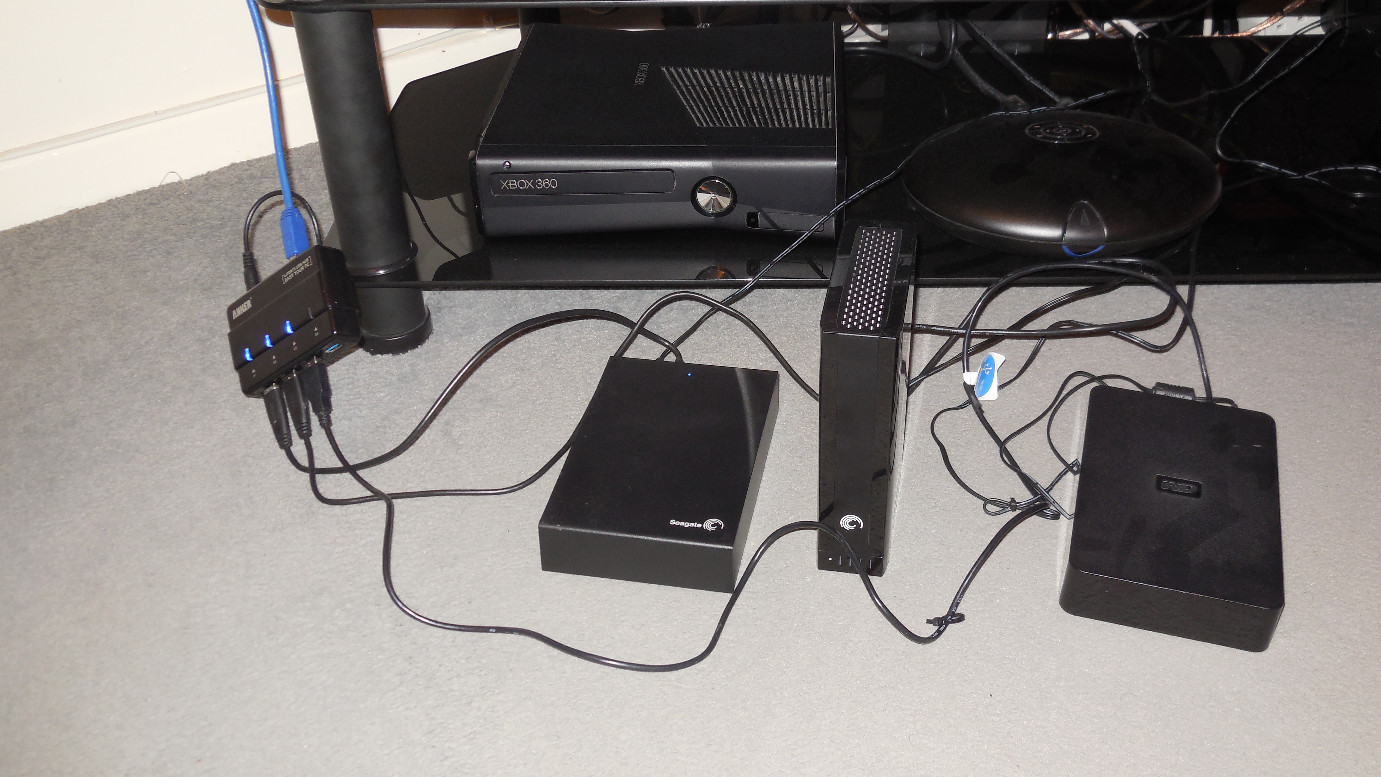

I have successfully tested both a powered and non-powered USB 3 HUB using 3 HDDs (2x 4TB and 1x 2TB) and works with no issues. See phones below.
Equipment:
The first test was using the AIDA64 Tools to see if they were detected.
Next was to test via KODI, as you can see all 3 HDDs detected - and I could playback content from each HDD:
Photo of test of Powered USB Hub (Anker):
Photo of test of Non-Powered USB Hub:
