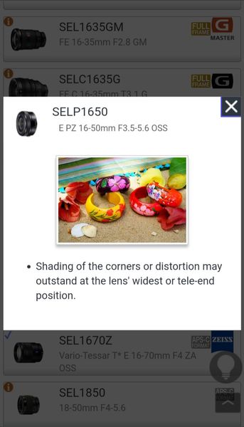

To see the same effect on A5000 you shuld tourn off the Shading Compensation
This option is unavailable on MEX-C3 and you'll see the real lens effect.
