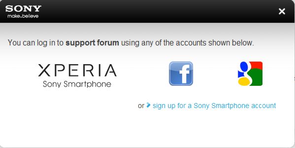

Do you have a Xperia Smartphone Account, Facebook or Gmail if so open the following link Sony Xperia support forum
and the following should appear..
then click on which account you wish to use to login to the forum & follow the instructions..
If you do not have either a Xperia Smartphone Account, Facebook or Gmail then click on the Sign up for a Sony Smartphone account link & complete the registration details..
