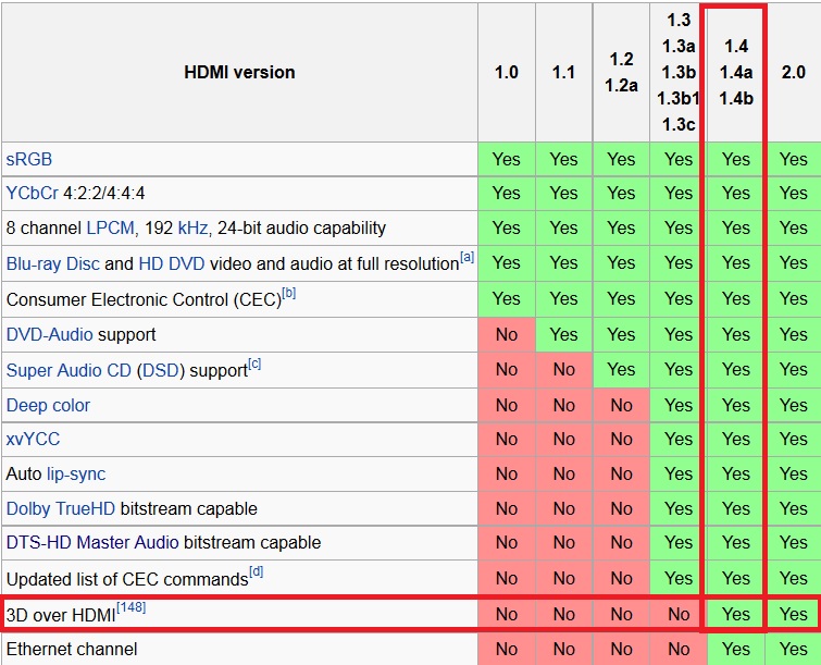

Do you have a newish HDMI cable (1.4a)?

Yes, I've seen the sites that say that 1.4/a is not necessary. However I can only advise the following information, and say that if everything else checks out............... (if you get my drift)
From HDMI.org
From Wikipedia:

Thats ok. Ive got no other idea's on why its not working to be honest, and its this part from the wikipedia article thats of particular interest (I think):
"HDMI 1.4a was released on March 4, 2010 and adds two additional mandatory 3D formats for broadcast content, which was deferred with HDMI 1.4 in order to see the direction of the 3D broadcast market"
Im assuming broadcast = Sky etc.
