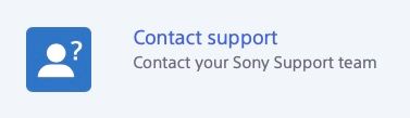

Click on the link below,
https://www.sony.co.uk/electronics/support/lcd-tvs-legacy-lcd-tv/kdl-32cx523/software/00271214
This is the article that discusses the termination of software for certain Sony TV models.
It's very long but at the very end it does say if you want to get the last software update that was available for
particular model contact Customer Service.
Scroll to the very bottom of the page and click on the contact support section.
See if that gets you anywhere.
