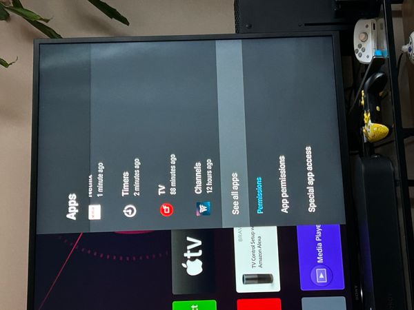

Hi @Milajayne, when you go to apps select see all apps, then navigate to channel 4 instead of Sony select and uninstall updates. If the issue remains, try the steps here: https://www.sony.co.uk/electronics/support/televisions-projectors-lcd-tvs-android-/kd-55xg8096/artic...
Hi; when I go to apps > all apps, there is no channel 4 to select, it only shows Sony select. And even at that, there is no ‘uninstall update option’ for any of the apps
Are you sure you are looking at All Apps.
The path on my TV which is different to yours but the path may be similar is.
Press the Settings button on the remote control.
On screen click on Settings> Apps> See all apps, press OK.
The list is shown alphabetically so Channel 4 shouldn't be too far down.
Perhaps you could share a screen shot of what you see.
