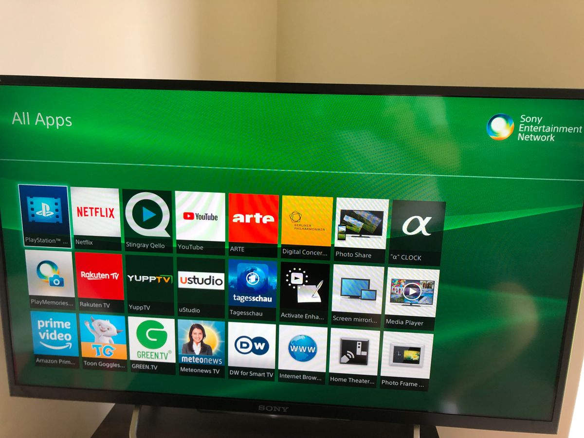

John,
It is KDL-32W705B running PKG3.006EUS.
Unfortunately I got onto Sony directly through one of the links on this post, and they have confirmed that after the layest software update most of the apps, or at lease BBCiplayer, ITV hub and NOWtv, have been removed, with no way to replace.
If you have any further information or suggestion, I would love to hear them, otherwise I think I just have to accept that they are gone.
Unfortunately, they are gone most likely due to the TV being an older model and the service providers keep dropping older models in favor of newer ones.
That said, there are some alternative ways to get those apps, and Sony actually has a link collecting some of them which you can check out here.
Hope this helps!
- JD
