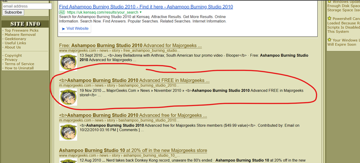

Did you try Ashampoo's free offering. Search Ashampoo and select these options. I don;t know if these latest versions allow what we need though.
https://www.ashampoo.com/en-us/burning-studio-free
And at your own risk although the site has a decent reputation:
https://www.majorgeeks.com/#gsc.tab=0&gsc.q=ashampoo%20burning%20studio%202010&gsc.sort=
