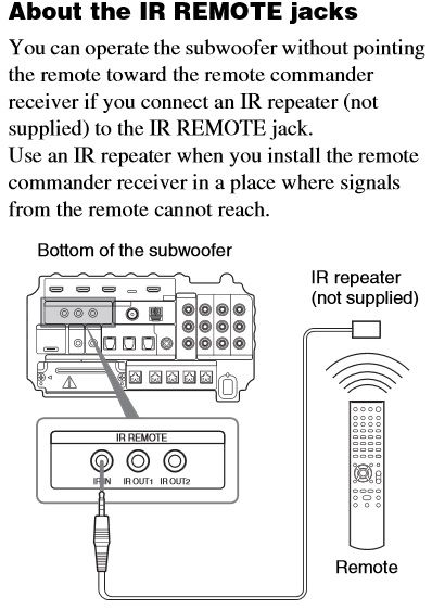

Unfortunately I have been unable to find this part either. Therefore you have 2 options:
- Try contacting Sony Support : HERE (to see if they can find it)
- Connect a generic IR repeater to the back of the unit, see below:
Looking on Amazon, I found this:
http://www.amazon.co.uk/Marmitek-Eye-universal-extender-cable/dp/B000MBY1FC/
There are many others if you search for "IR Extender"

Hi there
Yes, your quite right. The part you are looking for is:
Remote Commander Reciever (IR-R100)
Dimensions (approx.) 46 x 19 x 45mm (w/h/d)
Hope that assists
Cheers

Hello all. I have finally found a solution that works as a replacement for the IR-R100 for your HT-IS100 system. I've ordered several different types of IR receivers and finally found one that works. The only trick is, you have to plug it into the IR-R100 jack and not the "IR IN" jack. Link to solution below:
Infrared 38-56kHz IR Receiver Extender Cable
You can thank me later. 😉
