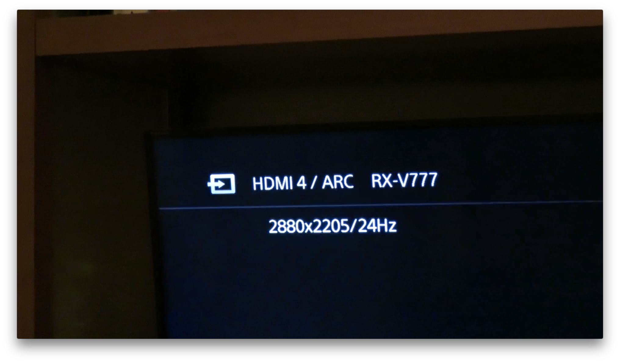

Later I tried several other 3D blu-ray discs and they don't even play: the TV (a Sony KDL-50W808C) shows a black screen with "1080p 3D" printed on the upper left corner, then the writing disappears and a new one appears: "2880x2205 24Hz". Then total black, "1080p 3D", total black, "2880x2205 24Hz", and so on, indefinitely (the movie never starts).

I add two pics showing the aforementioned writings on the screen.
I add a video too — sorry for the quality, anyway is just to show the timings of what appears on the screen.
