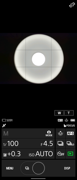

Did it!
Thank you for showing me that continuous shooting is possible.
Here's a screen shot.
Once you know how, it's simple.
Slide the slider instead of pushing the button.
Like Johan Cruijff said: 'once you know, you're able to see'

Thanks for the links. I can control various things in different modes, but as soon as I change from single shot to continuous shooting I am unable to take any pictures. Focussing seems to be working and is set to C on the front switch. Single shot works very well but I would really like the chance to use continuous shooting as the subjects are wild birds which do have the habit of continuously moving and it would be nice to pick the best image available. Camera is on version 2 firmware and phone is running Android 7. Again any guidance gratefully received. Thanks Pete

Thanks for the help. It is so obvious once you know. I will be using this tomorrow. Thank you once again. Pete
