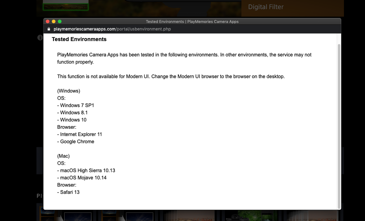

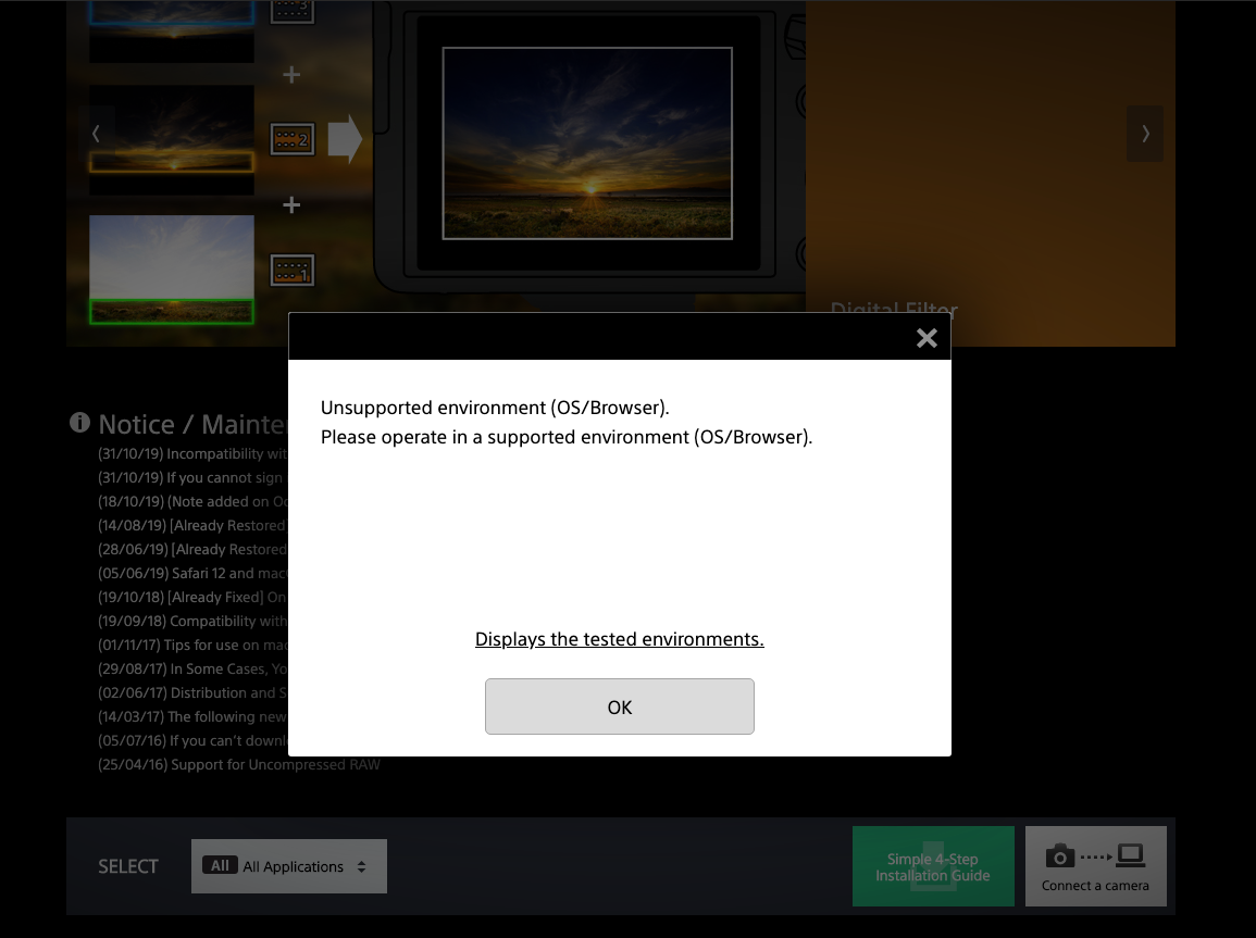

When I log on to my existing account and then click Connect A Camera (using a micro USB cable from my iMac to the camera) everything greys out on the screen and nothing happens.
Can you try with another Browser? Sometime the Browser Is the problem in theese case...
Unfortunately that didn't work. I tried using Chrome but got these messages:using Chrome
Ok so... Maybe is Catalina's fault?
Solved! It was a problem between my camera and my home WiFi. Once that was fixed then the apps downloaded from the Sony site directly to my camera. Thanks for your perseverance in trying to solve my problem - I appreciate it.
The change from Sony Play Memories to Imaging Edge is also very confusing at the moment. I understand the reason (32 bit apps not being possible within Catalina) but it's still not a seamless transition. I am waiting for a few months before I move to Catalina.
