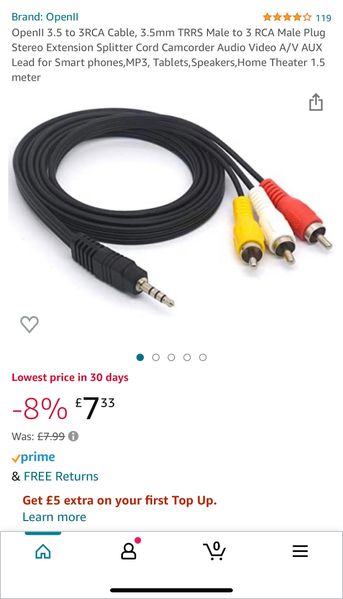

I think you will need an AV Out cable as originally supplied with the camera - something like this:-

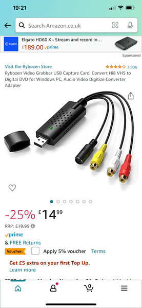

And either an old VCR with analogue inputs or a USB capture device like this:-
