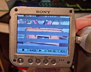

All the buttons and touchscreen controls work fine but the live view on the screen has lots of vertical multicoloured lines and you can't make out what you are looking at really and on playback of a tape (it came with 4 used mini DV tapes), 5 grey horizontal bars appear across the screen. Please take a look at the attached photos.
Live View
Playback
The first image is the live view and the second is the playback view of a tape. I have read that horizontal grey bars on playback may be due to the head needing cleaning so presumably I can just buy a mini DV tape head cleaner or would I need something more specialist for a Sony camcorder?
Is there anything I can do about the vertical lines shown during the live view, could this be an issue with the sensor inside the camera or perhaps a dodgy LCD flex cable, I have seen replacements available such as this: https://gbr.grandado.com/products/good-lcd-hinge-rotate-shaft-flex-cable-for-sony-dcr-pc55e-pc55-vid... but I am not sure if that would work or how difficult it would be to replace it.
