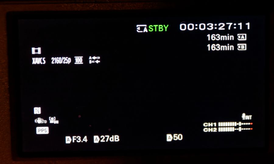

ON my new FDR AX 700 I noticed that the onscreen standby counter doesn't zero after reformating the cards, the cards don't have any information, yet show 3mins 27seconds before recording and when recording, it counts up from there, the firmware version is 1.01. Has anyone any information as to regards to a fix. Or is this a bug yet to be addressed?
Screener6.
Solved! Go to Solution.
Thanks, IamNic I will look into that but have since found the TC reset and it zeros it 😁
Hello @Screener6,
this is not the "Standby-Counter", but the counter for the movie-time - called user bit - used to judge how much footage the camera has recorded exactly since the counter has been reset last.
I would assume you don't have any use for it, so it would be best to deactivate this overlay all together as shown here:
https://helpguide.sony.net/cam/1710/v1/en/contents/TP0001492460.html
- Nic
