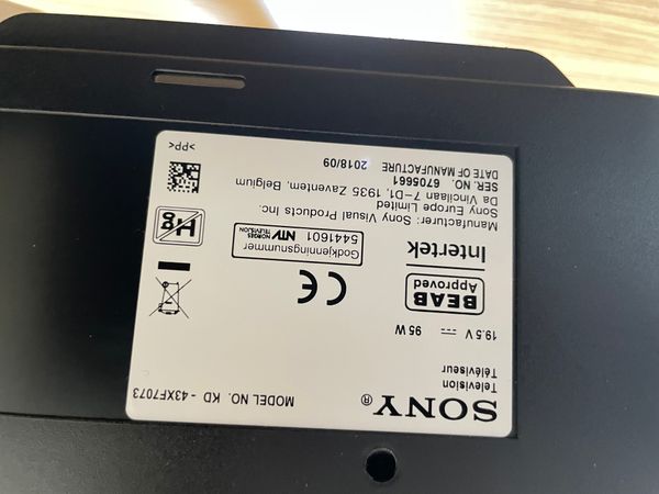

I don’t know if it makes any difference, but you have asked your question in the Android TV community. The KD-43XF7073 is a Linux TV and covered by the Other TV Community
I believe the key here is to set Subtitles On in the settings. I can’t help you as I have a Google TV so have no idea what the Linux settings look like. However it my be worth reading the manual or looking at the web help pages:
https://www.sony.co.uk/electronics/support/televisions-projectors-lcd-tvs/kd-43xf7073
Looking at the help pages, the only place that I can see for Subtitles in the Settings is (using the TV remote): Home -> Settings-> System Settings -> Channel Setup -> Digital Setup -> Subtitle Setup.
