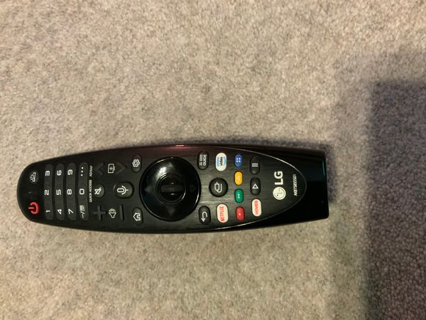

My DTR-T4000 YouView box is plugged into my LG GX TV, and this has what LG call a Magic Remote, which learns about the equipment it is controlling. It looks like this:-

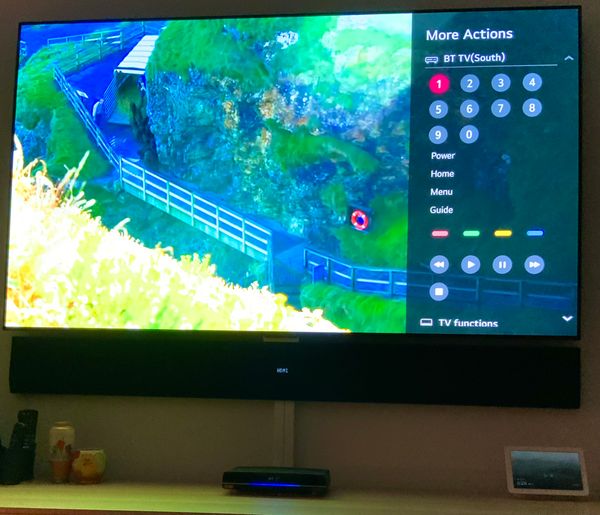

And none of the buttons mimic the blue YouView button on the YouView remote. However, if I press the button to the right of the zero (three horizontal dots, labelled AD/SAP beneath it) I get this display overlaid on the programme on the screen:-
which brings up more controls, and of which Menu is the YouView button.
It’s a long shot, I know, that Sony would have anything quite like this, but if there are any buttons on the Sony remote that open up a further dialogue rather than having an immediate screen action, this may be worth exploring for.

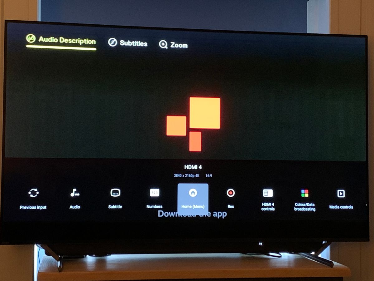

The Sony TV does have an additional menu button and I had been hopeful that would work, but all the additional control functions are greyed out and choosing them doesn't do anything. I think this would be the way to access the recording, but it's non-operational.
There is another option on the list there: Home (Menu) . This opens the subtitle shortcut, the same as the menu button on the BT box remote. But on the BT box remote there are two separate buttons for Home and Menu. It seems Sony have chosen to programme their Home (Menu) option with the BT Menu function, rather the BT Home function.
I think the only way for this to be solved would be for Sony to add some programming code to make these options live and working. I can't find anything in settings that would control these options being active or inactive. I wonder if the programmer took a break for lunch and then got distracted onto something else and never came back to finish it up? It has an unfinished business kind of feel to it.
