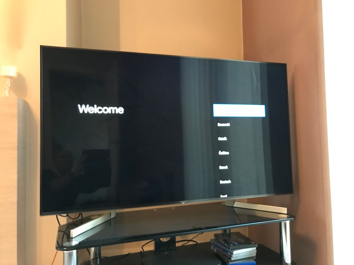

Sony Bravia tv bricked?
Hi, Sony 4k tv stopped responding to remote, voice control would still work though. Did a factory reset hoping that would cure it… sadly not.. all I have done is bricked my telly as it won’t go off the welcome setup screen as the remote won’t work. Have checked and getting a signal from the remote, checked with phone.
Getting a universal remote to check that’s not the issue.
but any help would be appreciated.
Andy

This is my model number, and the One for All Sony remote is also failing to oblige.
KD55XF9005
The issue is that I can’t get off the Welcome screen to connect to wifi to connect to my app. I did a factory reset from the App hoping that would cure the issue.
Any way of just using it as a telly and not having to go through the rigmarole of setting up?
Andy

Thanks for the responses…
Ethernet cable connected and using the Sony remote app It can see the tv and pick the device the IP address is correct , but sadly still no control over the menu options….
Must admit thought using the buttons would also do something in the way of scrolling through the options but not…
luckily it’s still in warranty so hopefully someone will come out and replace the IR unit as it can only be that…
Andy
