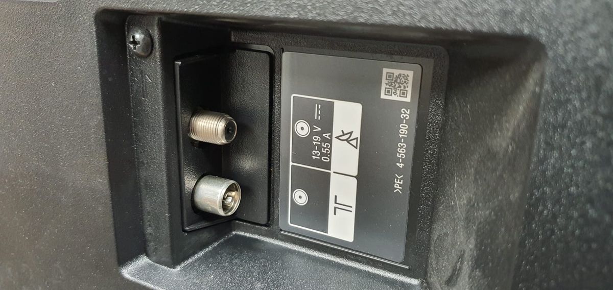

I just noticed on the back there are 2 models i wonder if my model is FWL - 65W855C but if it is there is a physical tuner on the back of the tv unless its a dud but this is getting really confusing now ?
If your TV model is fwl is a business product not a consumer one. And probably does not have a tuner. Check with the Sony business product division at pro.sony.co.uk
What i dont understand is there is a tuner behind it unless it is a false or a dummy tuner. i have attached a picture to show you also i am sure when we first bought these they had the tv option.
