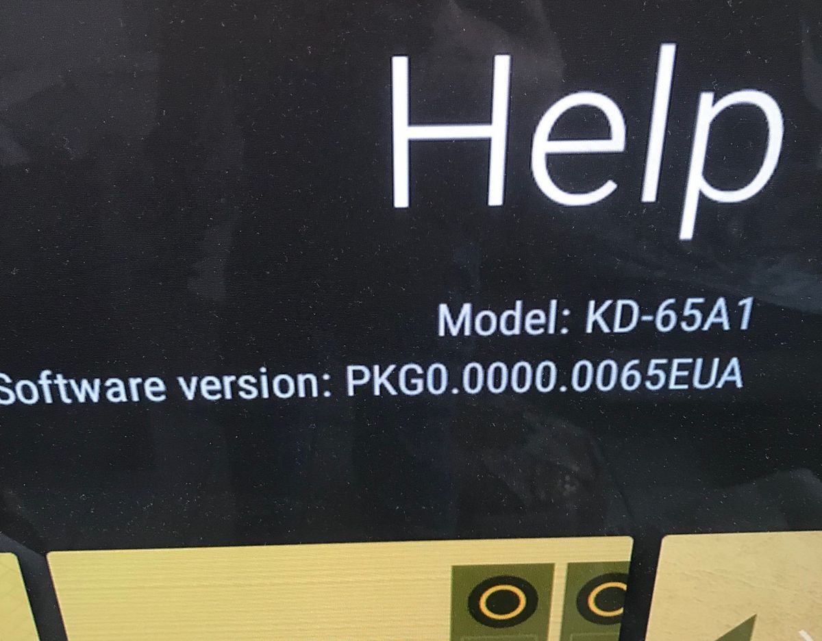

ahh. Ok, i was a bit worried. After manually updating it, it now shows PKG0.000.00065AENAA, and i dont have DV at all. Will format usb and try again, thanks!
Ive tried with 4 different usb-sticks now, and it wont install. Tried fat32, exfat, ntfs, still says PKG0.000.00065EUA.
Anybody have the same problem? No DV and no new searchbar.
Maybe you are trying to update with the wrong file. Do you own the North American A1E or the European A1? I have never seen the firmware version you mention in your post before. Press HELP on your remote and take note of the FW version on the top right corner. Have you not been tinkering with the FW already?
I have the European one, installed it from the norwegian site.. Not tinkered with anything, just turned the samba service off in the previuse version.
The FW revision your TV reports is a little worrisome. It could be an indication that a previous upgrade has not been successful. I’m sure others could shine more light here. Just to double check, are you downloading your FW file and following carefully the instructions from here?
Maybe a Factory Data Reset prior to upgrading might help.
Thanks for the reply! Yup, did exactly what i says. Also tried a factory reset before updating.. ill make a new thread on this,
