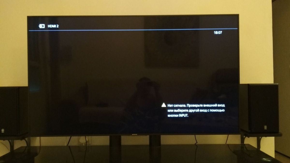

I set screensaver after 5 minuts of inactivity, sleep after 30 minuts. When PC is down or there is no input on any hdmi or analog ports I get message No Input Signal, port name, clock etc. TV displays this message forever and the panel leds are ON. I'm not using timers at all. For years I never shut down monitors, printers, subwoofer, etc. There is automatic sleep preconfigured on any devise I used for years. It seems totally bizarre to push power button every time to switch ON/OFF TV in 2018!
