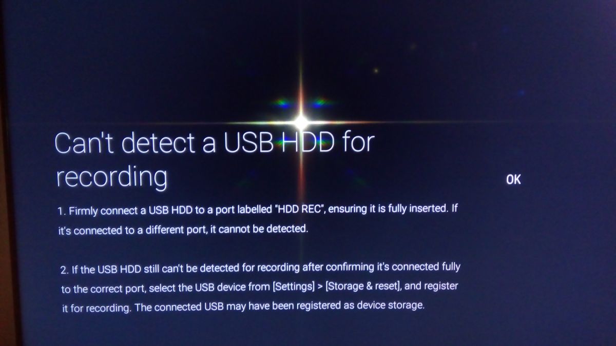

I just bought this KD49XG9005BU and trying to format and record on an external HDD attached to the USB port for recording. It doesn't work.

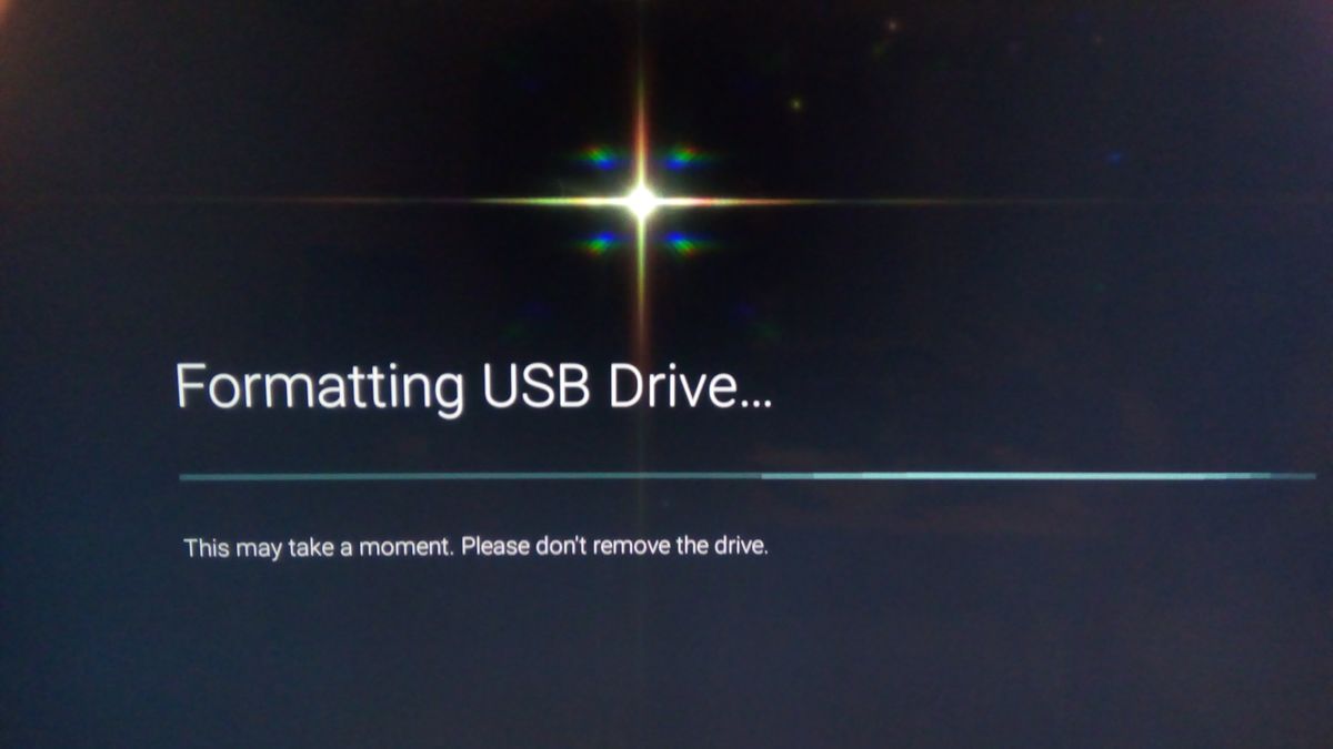

I plug in the disk - I tries a 1TB and 500GB disk. The first time I format it, it says it's ready. Then I try to register it and it stubbornly keeps saying it can't. I'll attach the images of the error. How to fix this?

Error message
Formatting

You are using a port rated for HDD REC? (Blue - USB3 - or labelled HDD REC)?
With a device > 32GB?
Direct connected?
Have you tried the performance check?
And all the other hoops you have to jump through?

Hi @Richlion2 How did you get on? If you are still having problems what is the make and model of HDDs and what are their power requirements. You are probably already aware that it must be a HDD and not SSD.

yes HDD REC port, Blue.
yes, 500GB and 1TB drives tried. Preformatted as NTFS on a Windows system
yes, HDD in Docking station, USB cable into Port directly, no hub
I'll check the article.
Thank you.
Richard
Are you sure you are registering the HDD for recording and not only formatting it?
