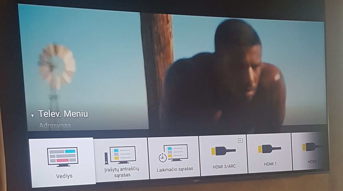

Hello, I have restored Tv factory settings and my Tv can't find my android box (M8S PRO+). Before I restored the settings was like in first picture. Now it is like in second picture. What i have done wrong? TV. KD-75XF9005
Now i can't control android box( internet tv) with tv remote.
