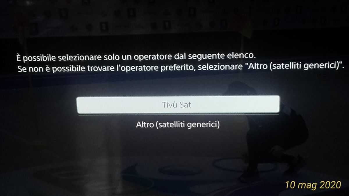

Hi, I need to know if you have a single or double LNB. TVSAT scan is performed through "scansione di rete" "network scan" this in order to have an arrangement of the channels according to a chart with definite numbers (Rai 1, Rai 2, etc...) If you do this operation in a different way you will get all the channels ordered according to their frequency.
@Flamerone talks about Italian initial configuration of TV set and I agree of course.
Here enclosed is a photo of the Italian configuration.
