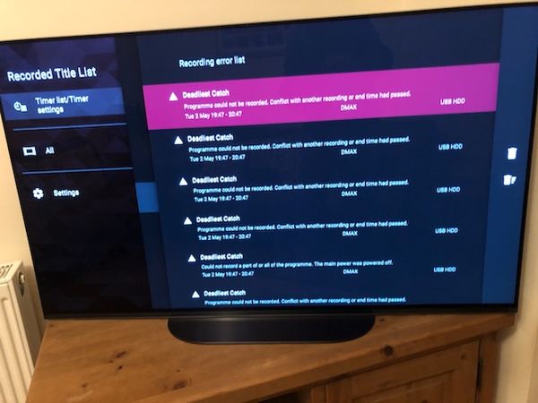

update
tonight at 19:47 TV changed to channel 39 (DMAX) by itself and no other channels could be selected so the problem persists.
i tried the idea I had of going through the system apps and services forcing them to stop one by one to see what effect they had.
As far as I could see = nothing narda nowt zilch.
so 1 factory restart later.
The error listing on the recording app persisted through the reset - how?
Pic attachment shows that
err recording list persisted through factory reset

If you come out of the Recording Error List and go to Recording Timer List
are there any entries in there and if there are can you click right to the 'trash can' icon and delete the 'event'.
Or have a look in your TV guide to see if there is a pink clock icon in the guide for a programme on DMAX at the
time the recording is set. (this will only show if your TV guide is set for TV (Freeview TV) rather than Live TV and Catch Up (YouView)).
From your recording list you can see the errors change when you have performed the factory reset, where it states the error was due to 'power down'.

Thanks for the thoughts dave
i have nothing in the recorder app recording list or reminder list. The errors cannot be deleted and change daily to the current day but stay consistent in there quantity and message.
there are now “pink” recording indicators for that channel at the 19:47 point or before or after.
