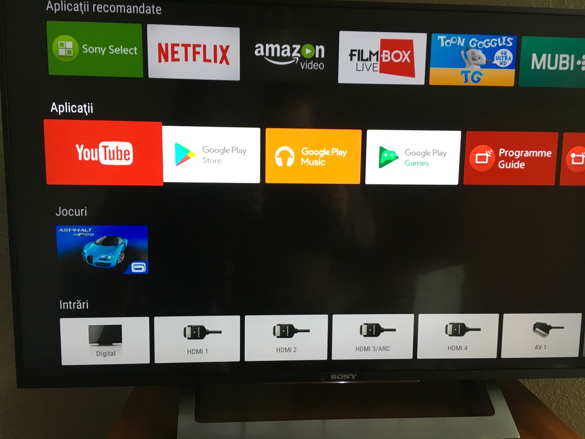

After the firmware update v. 6.2858 in Home > Featured Apps , the Amazon Video appIMG_0144.JPG became Amazon Prime and after Force Factory Reset came back to Amazon Video app , as can be seen in the attached photo . I checked in Settings > Applications and there it is Amazon Video and not the new Amazon Prime version that had been installed on update v. 6.2858 . Is there a problem ?
I would assume the forced reset deletes all previously installed apps and takes it back to out of the box state. So I would assume you have to set up/reinstall the stuff you had previously.
