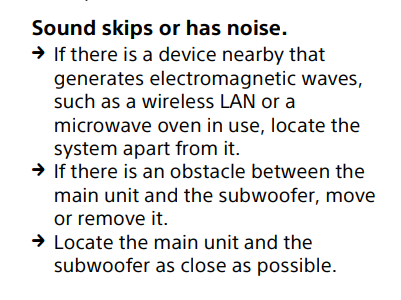

Hello @TheParader,
I found the following troubleshooting steps you could try:
The reference is to page 34 in the manual.
I would put my hopes on changing the RF Channel and only try the other tips if that doesn't improve the connection.
- Nic
Hi,
Make sure there are no electro-magnitic devices located between soundbar and subwoofer, if issue still the same you can contact Sony reps, they will direct you to the service center for inspection.

Hello @TheParader,
@TheParader schrieb:
my Virgin Router sits on the floor below the Soundbar....could that be it?
that could be the issue and interfer with the wireless connection between the soundbar and the subwoofer.
Have you tried changing the channel though first?
