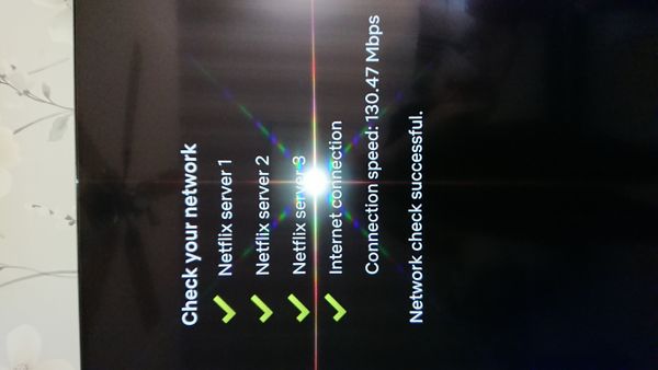

Thank you... Just did nexflixspeed test on TV this is my result. So I am within speed range but have issues as stated.
Hi I have reset the TV and freezing seems better, but there is a issue with the app stopping sound to sound bar after time watching but then I switch to TV and the back to soundbar and then it works.. Doesn't do this in any other app works fine in Netflix and disney and YouTube, and Im now using a ethernet cable and bravia core picture stream works fine. Wifi over 100mbps ethernet 84mbps and still runs fine no picture freeze... Testing to see if soind stays on using ethernet or is it the app.. 🤔🤔🤔🤔🤔 Plus in app it says upto 80mbps that's upto 80mbps it says in the app not 115mbps.
