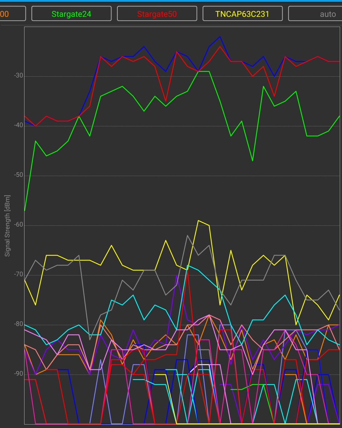

Just done a scan on mine
Hence many wifi signals.
