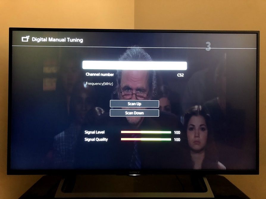

We have asked for some advice and have some requests for you.
Can you try to tune in full range and also check if the issue happens with other TVs connected to the same aerial system? Lastly, could you post a screenshot showing the signal strength?

I've attached some photos. First is signal strength as requested. Its fine. The next one is the settings for the screen display. The next 2 are for the Freeview channel ITV3 (standard definition & MPEG2 format). As you can see the programme is an old show originally filmed in 4:3 ratio and is displayed correctly. At the ad break the set automatically reverts to widescreen. This is what should happen.
The last picture is Film 4+1 (standard definition & MPEG4 format). As you can see, the aspect ratio is wrong. It should be filling the screen and not be in 4:3 ratio. All the standard definition channels on Saorview (MPEG4 format) exhibit the same characteristics as Film 4+1. Regardless of programme content the aspect ratio remains 4:3. I've checked another tv in the house (Sony KDL-40R483B) and the programme is being displayed properly (widescreen) with the same screen settings.
