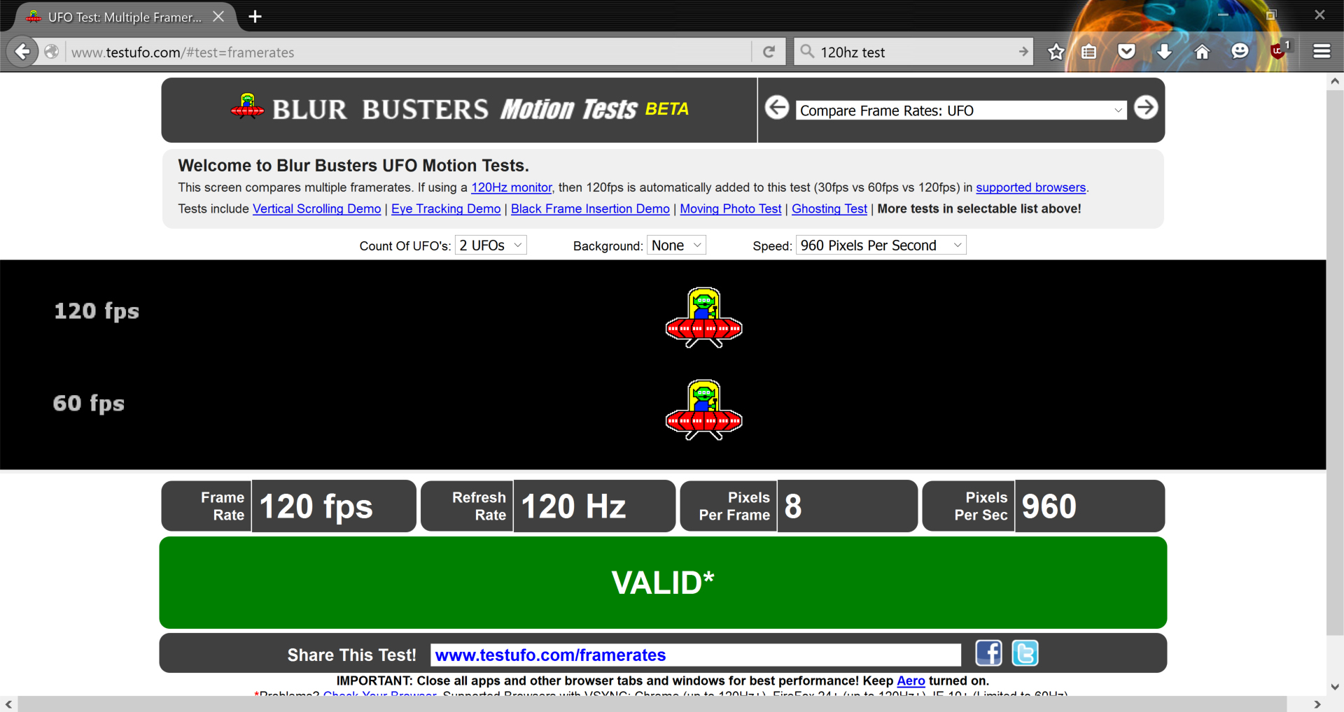

I've gotta problem. I put custom resolution in Nvidia settings (1080p/119hz) and it only shows 1/4 of image, distorted. Any clue?
I've got 120hz sorted out but I believe you don't realise it doesn't really work. I've noticed almost no improvement. And to back it up, I used a frame skipping test. And unfortunately it confirmed my fears - this TV skips every second frame so this "120hz" is useless.
You can't have set things up correctly, do you have hardware acceleration enabled or disabled in your browser settings?
Do you have v-sync enabled or disabled in your Nvidia Control Panel settings?
My results :
Refresh Rate Test :
Frame Skip Test :
Project Cars In-Game settings & Fraps and MSI Afterburner OSD Framerate :
Project Cars In Game 1920x1080@120 HZ V-SYNC ON - Fraps & MSI Afterburner OSD :
