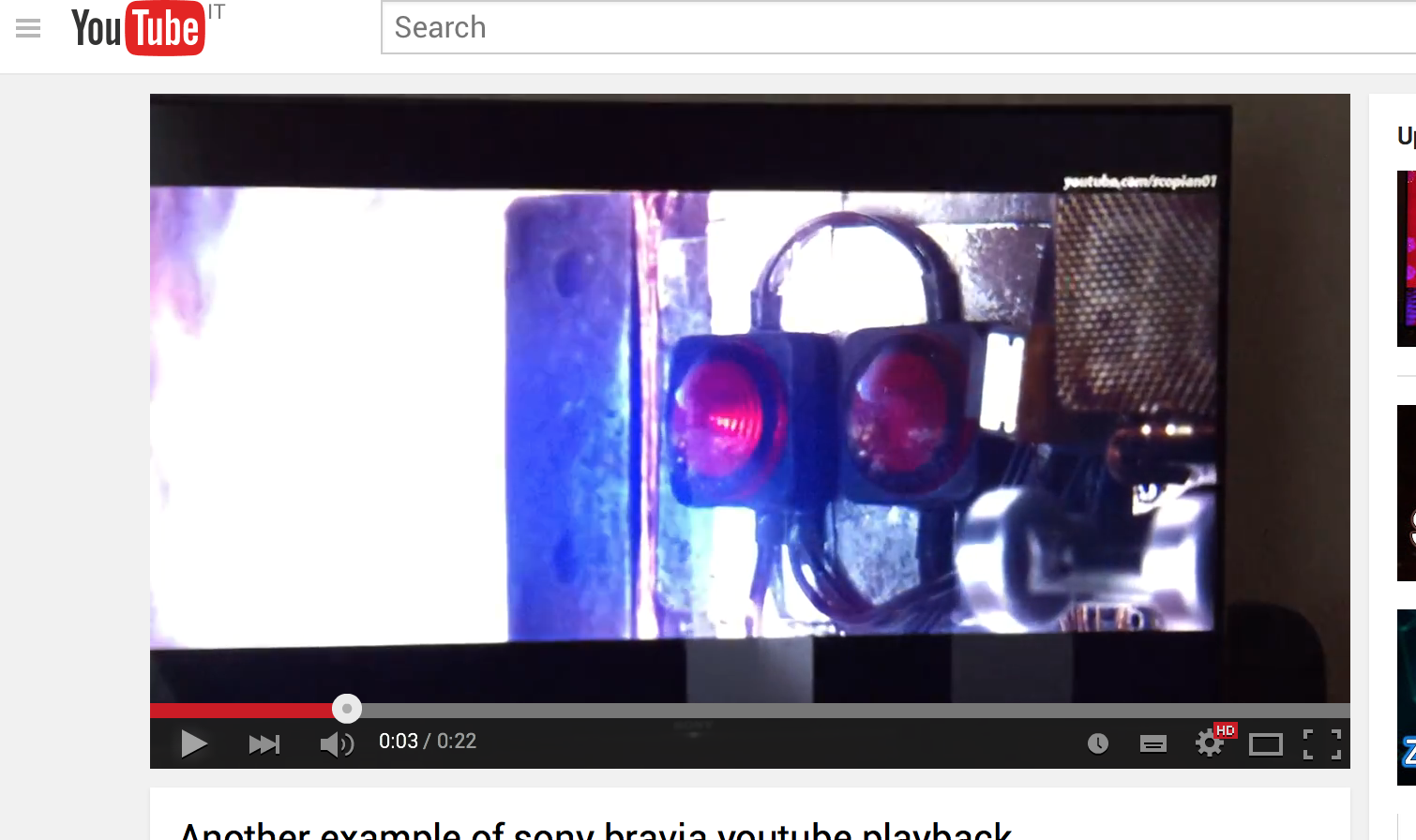

Don;t get me wrong but I've tried to play the first video (https://youtu.be/uy9mnBw5S3M) from my Mac and it is a mess indeed. White rectangles appearing, pixelation, noise. Here an example:
Is it what you're getting?

Hi yes that's exactly what I'm getting
Seems strange that it's only youtube, netflix and amazon are perfect....

Ok, but that's that particular video. The screenshot is from my computer, not the television. It seems to me that the video has been badly converted inside YouTube. Then if you watch in on television it looks even worse due to the much larger screen.
What you should do is to search for "4k HDR" videos and watch those ones at full resolution (2160p). If they show fine (as I suspect they will) the television is ok.

Ok got home and recorded a better example:
Here's the original video: https://www.youtube.com/watch?v=vXcFGgwP1J4
And here's what it looks like on my TV - can you see the problem now?
Cheers in advance for any advice!

Hmm.. yeah, that looks pretty bad. I'd suggest to try to uninstall any YouTube update (if any and possible), but since you wrote that you already did a factory reset I doubt it would change anything. Does it happen only with YouTube? If it happens with other video apps I'm afraid the tv is defective.
Actually, now that I think about that. Try to install Kodi. It comes with an YouTube plug-in as well (which must be enabled and configured. You can also use your YouTube account). You may see if it works fine from there, just for testing purposes.
