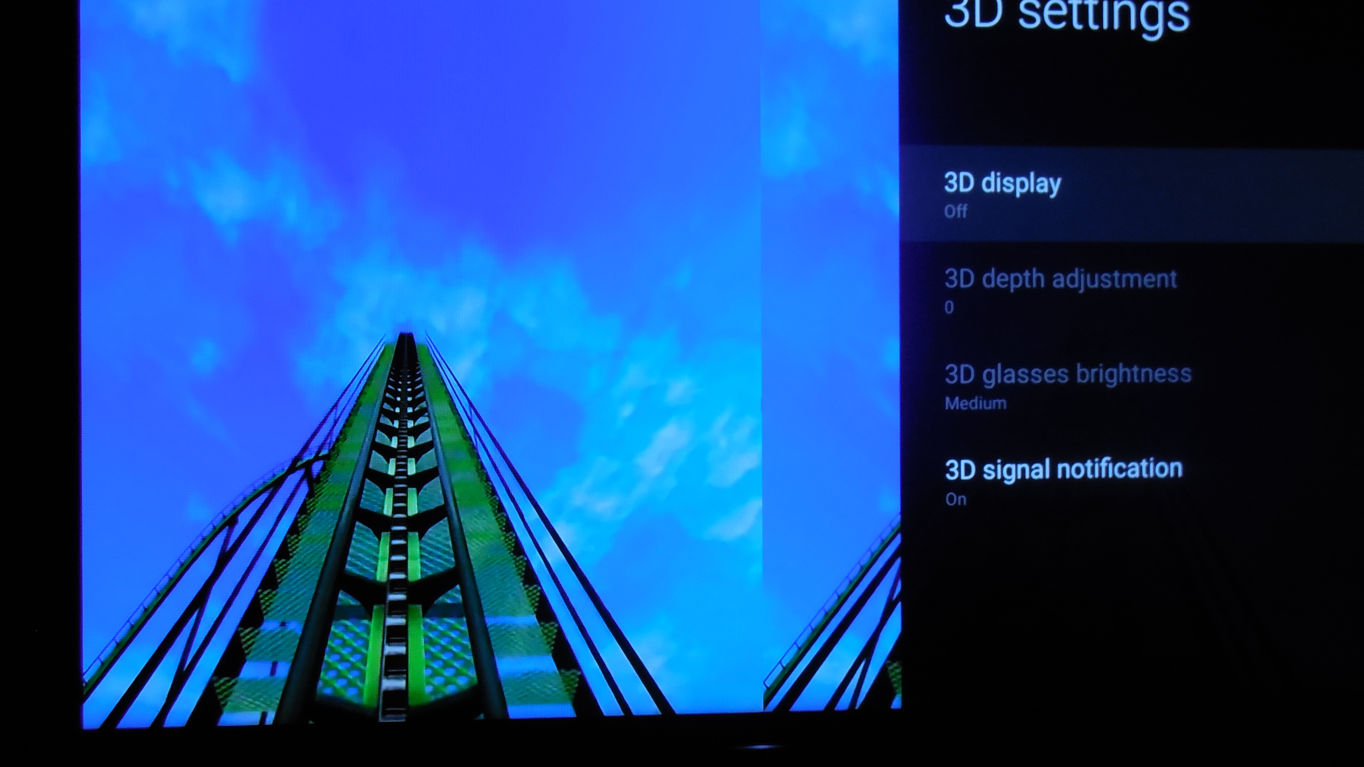

Although it has worked previously the 3D function on my Sony KD-55X8509C no longer works. Using either the Action Menu or Settings:display the option to turn 3D on no longer functions, it is set to "off" and cannot be changed, 3D content cannot be played either from a USB or from 3D content on Youtube although both have worked previously. Is the issue linked to the recent software update or is there a fault with my TV?

I have just tested the 3D on my KDL-43W805C tv using a clip from YouTube (see pics below). The 3D option is in the Action menu and can be turned on. I can only suggest a factory reset. If that fails, can you provide more information. Such as which youtube clip? If its a 4K 3D demo, then this will not work.

Thanks for your reply. Yes I have tried a factory reset but still no 3D. The 3D clips from Youtube that used to play fine no longer do. Then 3D food fight did work very effectively in 3D previously:
