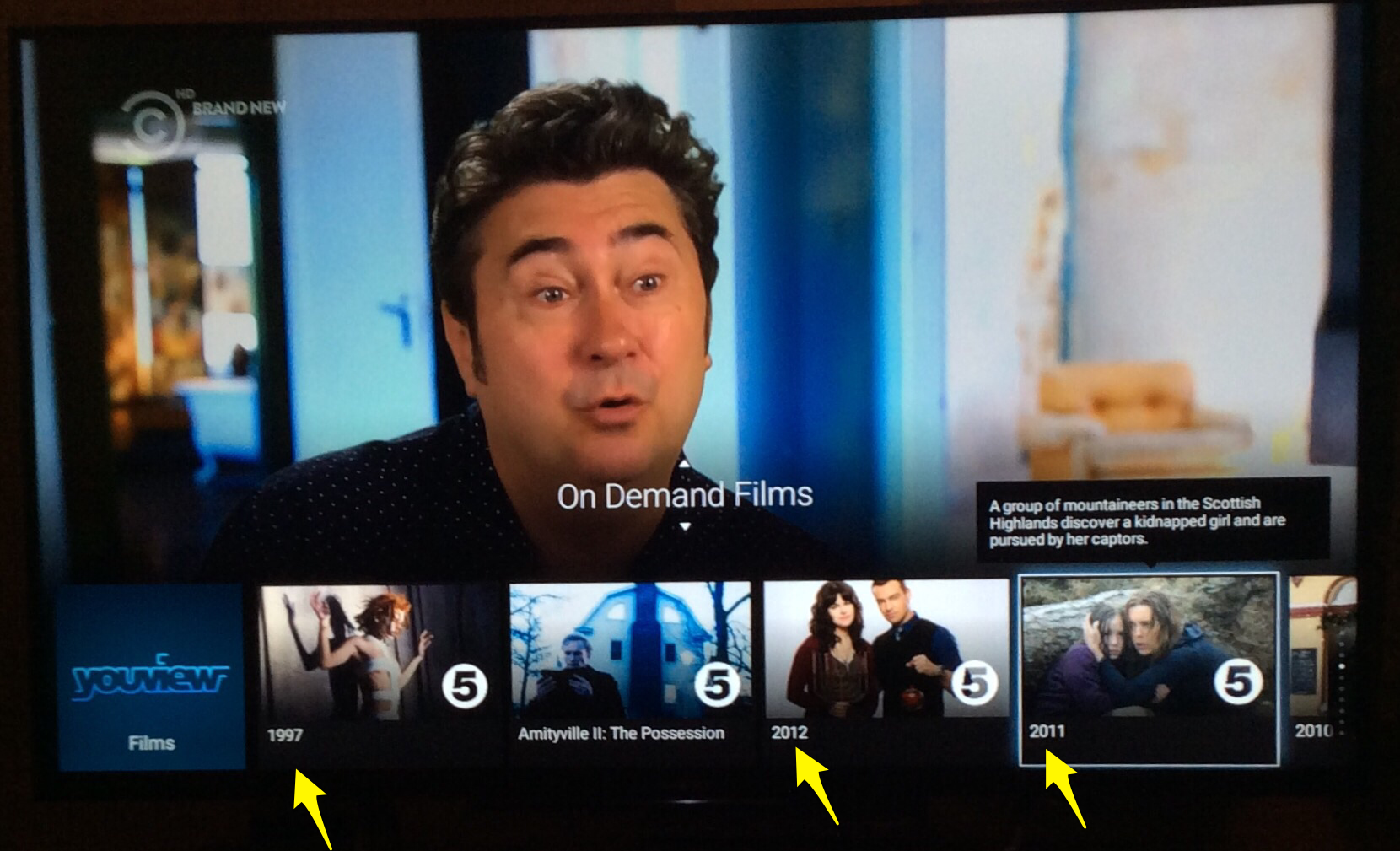

@Anonymous I think a YouView issue but when using the Discover , YouView Films, the Channel 5 films mostly have a year date substituted for the title. As this shows, I don't know how to report this.

I too noticed that with the discover button and youview but disabled youview on day of release because it was....

It only affects the YouView discover mode, for channel 5 films, then it seems most are affected. One or two get the correct title. If you locate the film in the 5 on demand player, it has the correct title. It has been like this since the launch of YouView.
Pas for the use of the discover function... Someone has to test the software, as the suppliers seem not to.
