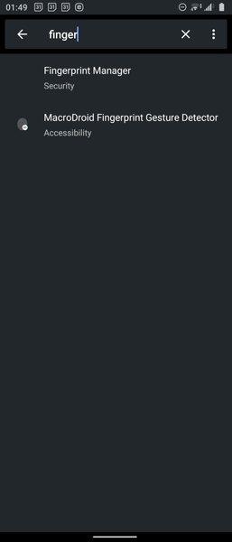

I have an Xperia 1. Latest Android update installed yesterday. fingerprint scanner seems to have disappeared. I've looked on lockscreen settings and it doesn't seem to be there. Pin only. Very annoying. Any thoughts?
What if
you type finger in settings?
