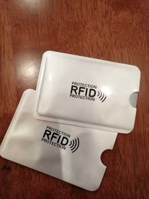

My NFC suddenly stopped working after I tried to scan my bank card inside RFID protection sleeve.

It stopped working after I tried to read my bank card inside this RFID protection sleeve:
Now I don't know how to fix it.
