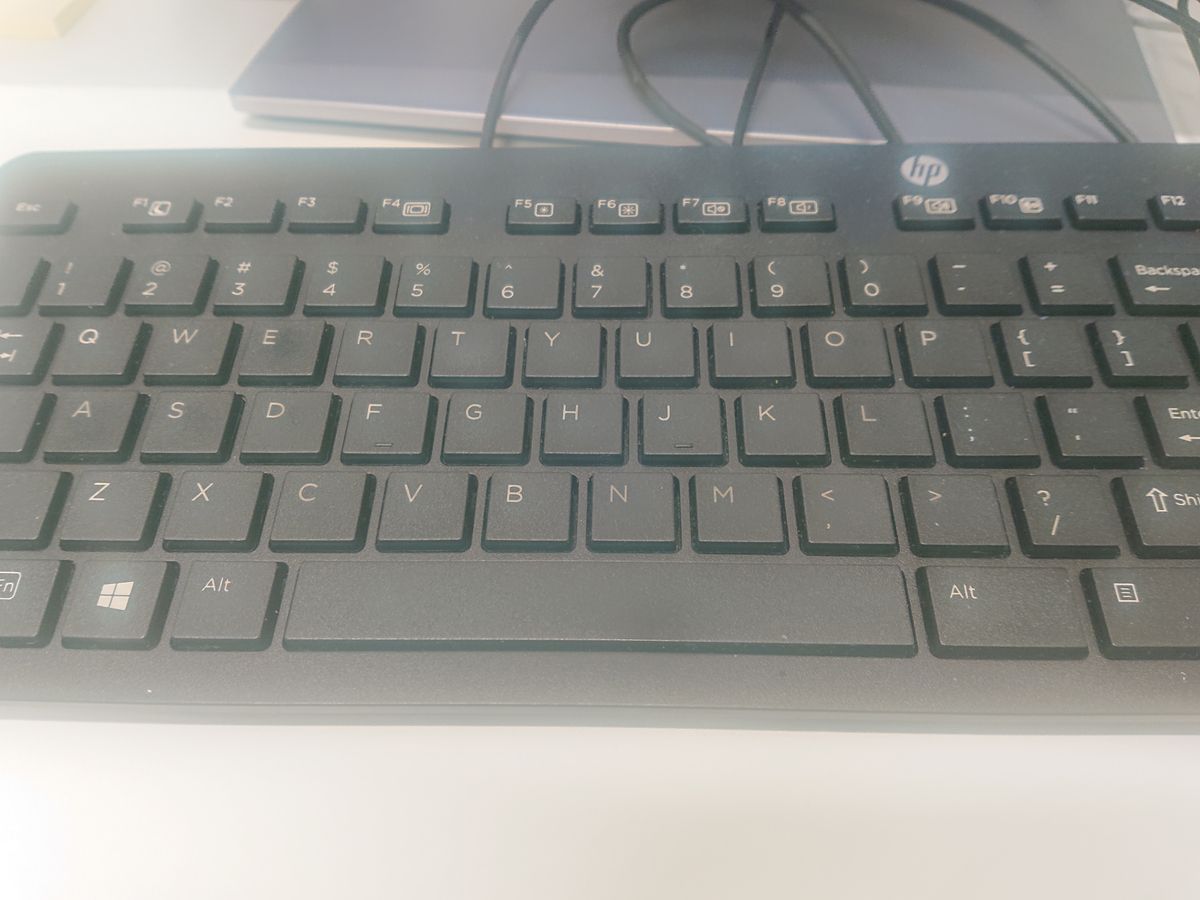

Only a few months after the repair of my XZ2 Premium and the faulty coating on the replacement has now completely come off. Less than a year old and this is the hazey crap quality photos that my flagship Xperia now takes. Gutted to say the least that I've had this experience. Given the hassle to have it repaired under warranty the first time, I'm not sure it's worth going through again. Looks like it's time to buy some cerium oxide to see if a polish will fix it or buy a replacement OEM back case that hopefully wouldn't be manufactured with a stupid dodgy coating on the camera glass. I've always loved Sony phones, but this is definitely the last one I'll own after this terrible quality control experience.
This is a comparison photo taken with the front facing camera just to show how terrible the rear camera is once the coating wears off excessively.
