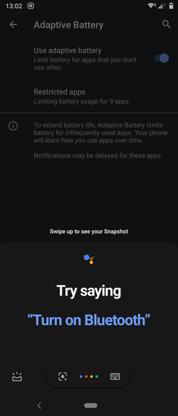

Hey @Strampke good suggestion, unfortunately I already checked that, Android 10 doesn't seem to have battery saver mode any more. There is stamina mode which I have off always and adaptive battery which I have tried turning off and also excepting Google app from when it is on.
I software repaired and factory reset my phone a few days ago for Sony support and Hey Google voice match wasn't working after that with the phone running the way it is when you first unbox it 😞
I'm afraid my suggestion was not good. 😒
I have Adaptive battery switched on and even then OK Google obeys my commands.
