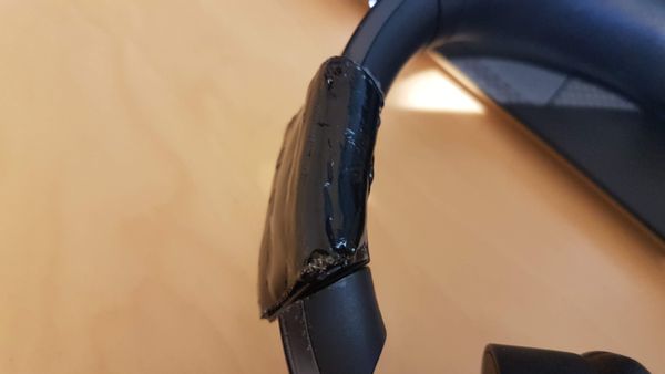

I completed my own repair on my headphones just over a month ago and it seems to be holding well.
The outer band had not cracked yet so this might not work if the outer band is also broken.
You just need some epoxy resin and some metal mesh.
For the side that had broken i molded the mesh to get the correct shape then coated it in epoxy resin. I left a strip in the middle uncoated so I could flex it a bit to get it on the headphones and into position.
I then glued this in place with some evo-stick 'serious glue' and coated the remaining strip of mesh with more epoxy.
After it dried I painted it black.
For the side of the headphone band that hadn't cracked I epoxied two small strips of the metal mesh onto the weak spots of the band. This will hopefully re-inforce the plastic and prevent it cracking.
It's not the prettiest repair but it's relatively cheap and works!Mesh sleeve with epoxy
mesh strips with epoxy
mesh sleeve fitted and painted
Epoxy resin and steel mesh
