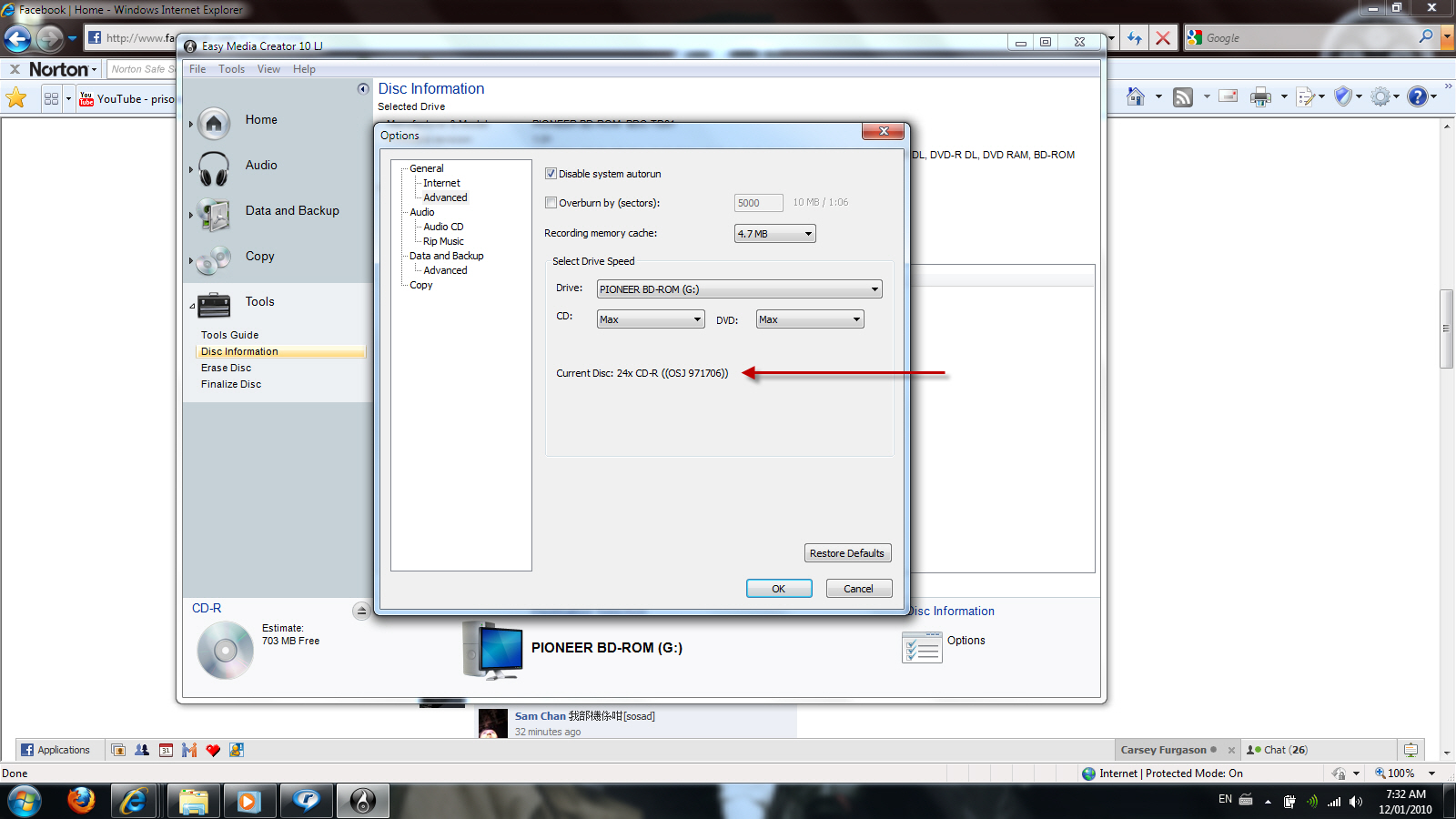

Finally I use the Roxio Easy Media Creator 10 LJ,
and burn the CD with almost 16.0x

I insert the Memorex 52x CD-R 50 times to the BD ROM drive(BDC-TD01),
I found that,the Roxio could not identify the Max Disc Speed,
Most of the time is 24x,and the lowest lock on 4x
