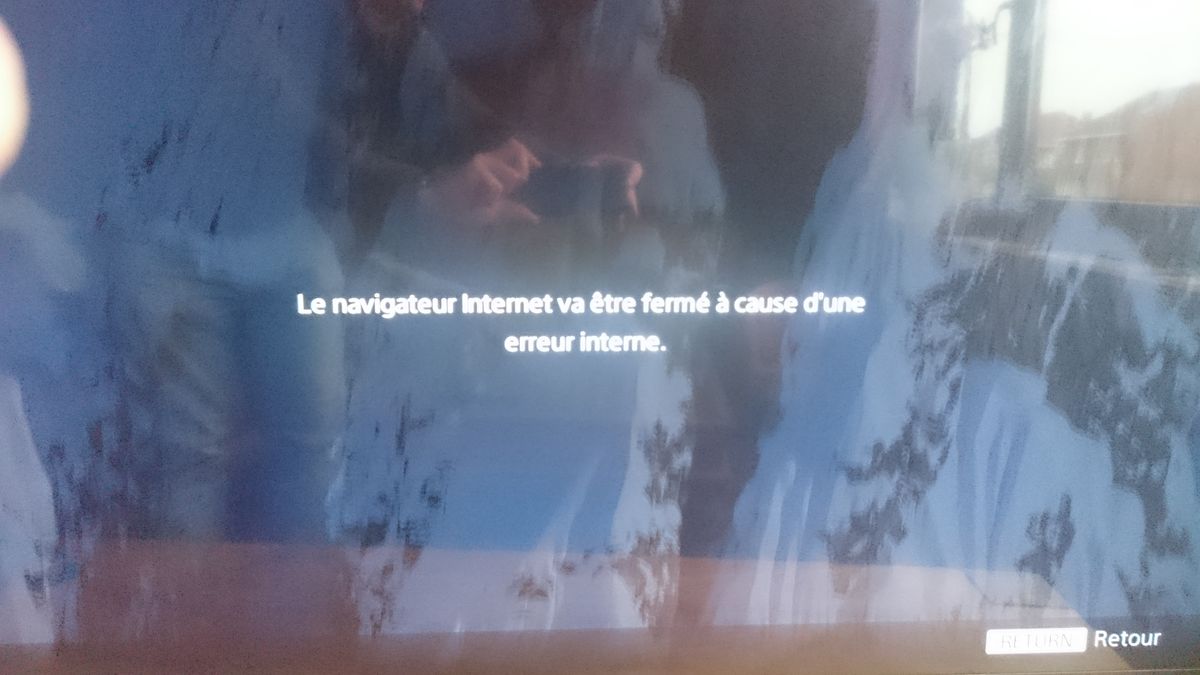

I tried to update the internet content, but that doesn't solve the issue either. It's quite annoying as the video is playing just fine, but is impossible to watch.
It gives this, you can see the video is playing in the background (I selected the first video available which is something in the mountains).

At last, I found out....... It works now....
Here is the technical explanation for those interested:
I have a DNS cache on my network, it is configured to resolve some advertising domain names to an internal server which serves nothing but a blank page.
At some point, the TV browser asks for ad.doubleclick.net on port 443. This resolves to my internal server (172.20.0.254):
1418387596.667 5591 172.20.0.72 TCP_MISS/200 4257 CONNECT ad.doubleclick.net:443 - HIER_DIRECT/172.20.0.254 -
Given it's port 443, when the browser connects, it gets an invalid certificate when trying to fetch the ads and crashes.
It might be something else along that way, but the result is there, when I enable the connection to doubleclick, youtube app works.
I would still consider this as a bug as it's not supposed to crash for such a thing. Imagine if doubleclick was not working, it would also prevent youtube app to work.
