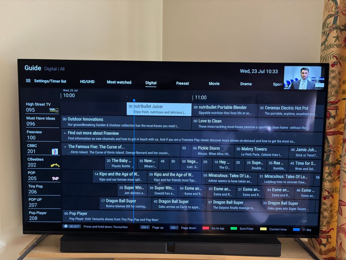

I have lost all Freeview HD channels from the EPG and despite re-tuning many times they do not appear. The EPG shows channels up to 100, then jumps to 201 - see picture. EPGSoftware is up to date and no other issues seen with the TV

I have done a sweep from CH21 to 69 and it does not pick up any HD channels. Hannington uses CH39, 40, 42, 43, 45 & 46 for the Muxs. Its almost if HD is disabled on the TV
