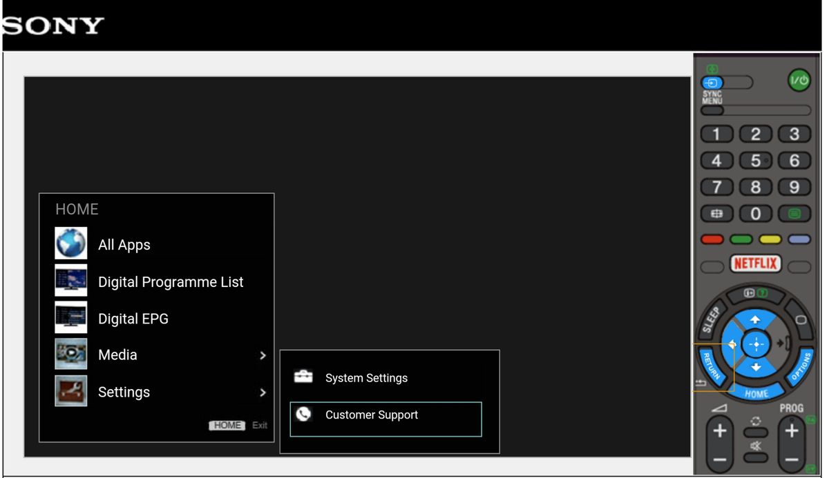

I think it should be under :
Settings > Customer Support > Factory Settings
Cheers

thanks for the screen shot - yes that is what I've already tried.
